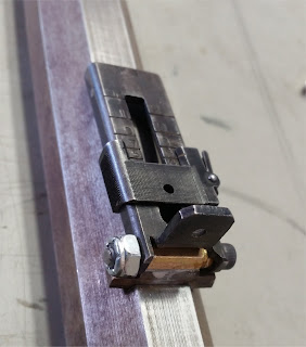

Rear Sight:
It's a MKII sight with a brass tube inside which is plumber silver soldered to a steel base.
It broke loose after about 8 shots, I hit it on the edge of the bench lifting it up to shoot just one more shot. Grrr. ^y%
