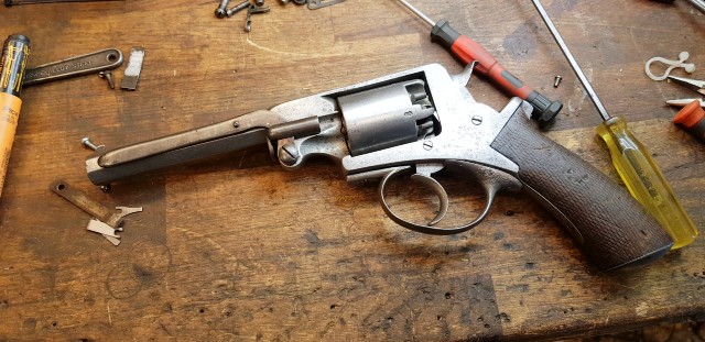

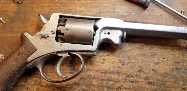

Anyways. The gun is an old original 44 cal. Or more to the point 54 bore,as the Brits insist on calling it. Worn..but for the most part there.

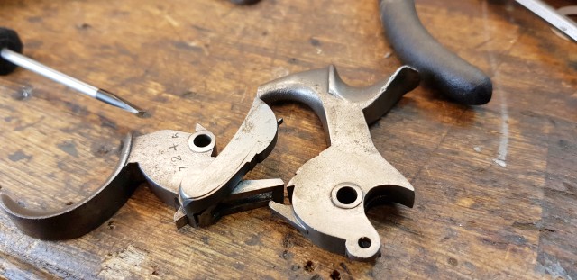

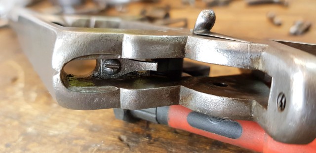

Actually bought it as "damaged" in as much that for the time being DA mode only. A small piece/link is missing inside the action for the SA to work,will have to fab that myself.
On a general whole though seeing what we forked over for this piece..better condition than expected.
The trigger return spring was missing too,and this is a V shaped jobbie. Handled that by using one from an old scrapped lock for a Swedish musket and done deal. Works a million bux why the gun now is at least usable,albeit DA only for the time being.
Build Q is high. More so than most US made counterparts IMO,and..more complex as you can see too. That the hammer and trigger,and these things lock up a tad different vs the US SA guns. Those familiar with the DA setup of the Starr will nod tho i guess..
Yeah. That there spring is what´s to control that small link that´s missing. The thing is to pivot on an axle,a screw,in from the right side of the gun and lucky me i even found an animation of what it looks like and how it works on YT.
Idea here is for a quick sort of resto. Mainly just get the thing rolling,working,again. Rifling is so-so to be honest but..i´ll keep my yapper shut as far as performance until i´ve gotten to try the thing out.

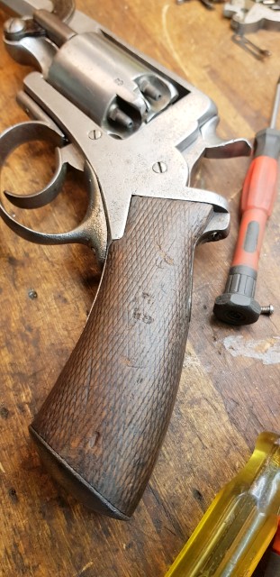

Make no mistake. An Adams is a full size revolver alright. Nothing small about it at all. 5 shot cylinder though,for whatever reason.
Sports a mechanical safety on the right side of the frame too. The DA mode is rather smooth..not excessive in any way or manner. Absolutely fully shootable in DA mode if you ask me.
Welp.
Stay tuned. I´ll update as this thing progress.

Hm.
Looked around,and in turn asked a few...
Yep. That´s SIS-2241 stainless.
´N due the fact that..well,iterations as i had nothing to on apart from approximations. After that shot in turn i added some material with the TIG to act as a "wall" for the sear spring to work on.
Well. Albeit crude as of right now it DOES work. So..one Adams running both ways leddies n gäntlemän...  (?^

That SA link i fabbed,got issues with the spring for it binding. Tried to look into it today to no avail.

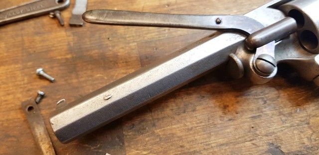

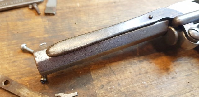

On the loading lever.
That was designed by Mr Kerr. Yes,the same Kerr that handed us the fabled revolver and rifles of the civil war - out of England.

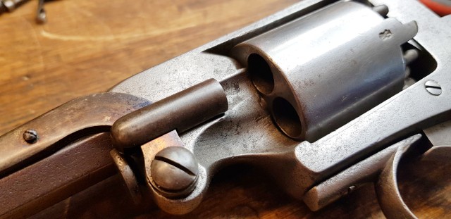

The loading gate of it is simply to cramped. Couldn´t make the 220s fit in this case either so that´ll have to be relieved a tad. In turn just like the R&S a fresh front sight is needed.
Albeit not as extreme off as the R&S still off by quite a margin,hitting like a foot high at 25 meters. Need to remedy that...but that done (the front sight and the relief cut) i´d say we´re in business!
