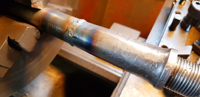

Well lads. The OEM Chassepot is a paper cartridge gun that uses an approx 385grain boolit propelled by 88 grains of blackpowder. As it´s a 45 cal gun it´s thus basically a 45-90 such - in essence.
As the thing sports for instance 1:20 twist and what not i this time out figured i´d step it up a bit,and took to turning myself a chamber insert for a 45-120 approx.
Seeing that i turned that insert out of high end steel but be that as it may the damn barrel is still the..by all means for the time rather serious steel..still just low grade crap compared to what´s available today.
Might be that blackpowder can only produce that much pressure,but lately having seen a few guns where crap´s gone ape.. What i did was set where that insert ends in a rather anal fashion.
I then proceeded to cut the barrel off at that spot. As i now had the bullet entry point,for the rifling that is,at close hand i opted to set jump as well as forcing cone and what not to my hearts desire.
I then set the barrel and chamber insert up snug against each other on the lathe and hit it with the TIG welder and some rather specialized TIG weldrod (as the high end steel vs the low end is a bit of a mismatch and can create cracks and god knows what else i´ve you ain´t within the loop).
So. Cut a couple of "welding ditch" into the barrel and insert both. The lathe as a make shift jig,centered the pieces using dial indicators and went at it.
The OEM piece of the barrel i had cut off (that carries the thread to bolt it to the action and so forth) i cleaned out and shoved that atop what i had welded together and..in turn hit the thing once again with the TIG,this time with regular "crap" weldrod.
This,in short,has handed me a very very strong chamber construction to play with,and there´s of course a reason for this.

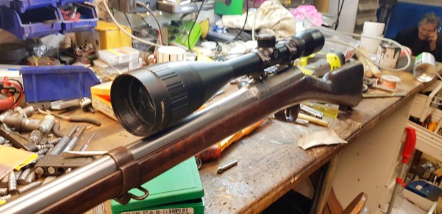

Having turned and in general cleaned the welding areas out and..in all honesty feeling good about that i came to adress the scope mount.
From earlier i had turned a couple of steel bungs that i had basically just welded into the receiver. This coupled with the cast aluminium scope base though had handed me a 6-24x*50 scope that came to rest a tad to much above the barrel face than i cared for.
Thus..tossed the base on the mill and cut a few millimeters out of it. Bad move..the thing turned WAY to weak so going to have to replace that with a home brew base out of steel...
But nevermind.. I at the same time tossed the entire receiver onto the mill and cut yet a few millimeters out aaaaand..about right there i got happy again.
No. It´s not "to close for comfort" to the barrel yet. More so..cool enough.
Reason behind this is rather simple. These old rifles were never intended for scope use,and to do what i have in mind here necessitates a scope seeing the shooting distances involved here. So. Reason for getting the scope as close to the barrel as i´m comfortable with is that then i don´t have to adress the comb of the rear stock as drastically.
What i have in mind,to go with the era and looks of the gun,is one of them strap on leather jobbies. in turn i plan for a ditto butt plate/limb saver too.
Huh? Well guys. I´m by NO means a stranger to recoil but this IS a 45-120 rifle of modest weight,all said and done,why i´m going to equip it to the best of my possibilitys as far as that.

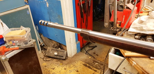

Ah! Yes! The muzzle brake. Uhu. This rather simple little device i hope will help immensely. I opted to polish the barrel as a whole and ..it DOES show - the split line between the brake and the barrel.
But. Having done this i immediately thought to myself that...either rebrown the thing or blue it - the way i do it. Salts only that is,and i both hope n presume this´ll make that joint disappear more or less.
Yeah baby!!  (?^ (?^ ->i

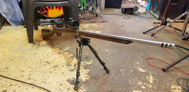

Here we friggin go! Had a spare mid barrel band and took to turning a small collet to TIG weld to that band,thus handing me an installation point for a bipod.
Drilled the thing and tapped 6mm metric (of course) for a wing screw. Will dimple the axle on the pod to make them interact.
As a whole..i´m turning semi pleased with this thing. Now to adress the bolt..needs to be done. That and the firing pin(needle) and spring et al.
The Anschutz match trigger is already on there and works a million bux..so? We´re getting there...bit by bit boys  &j( (T^
Net result here is a 45 cal rifle from back in the day that´ll use a sorts of 45-120 cartridge that propels a 500 grains and up boolit down the range.
Looooooooooong distance i hope. Going to be a very very interesting trial this one. Hafta admit... M__

Funny. All said n done though sometimes..steel is just steel. The mill made short notice of turning the edges of it 60 degrees with a Brownell jobbie made for the task. Leaving them Millet rings something to grab onto.
Now. Of course the base needs a couple of set screws or similar to keep the two rings in check as recoil enters the picture,but that´s a remedy simple enough.
Nah.
Now..for the scope..and what i´ve got in mind is the most up the wall you could ever imagine  ->i (?^
Indeed. Glass helps,and why not then add a little humor to it too while at it.
