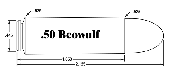

As it turns out shells for the 50 Beowulf looks like they could be made to fit with a mimimum of effort. That is.. IF this is a 50cal one, which it most likely is.

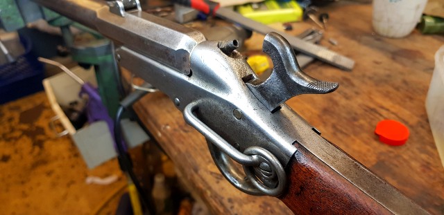

Ripped the thing apart first thing basically just to come to conclude it was in good working order. Neat!  {L*
On a general whole the thing is remarkably intact and complete. The rear sight leafs still keep their "300" and "500" markings. I assume that to be yards and let me tell ya.. after having shot this thing today i have NO disbelief it´ll handle that.
The trigger, the lockwork, reminds a tad of the fabled Wesson rifles of North-East US. Maine and what not. Inline alright, and that turned out to be a tad different as the hammer kind of visually intersect the sight picture. Or more to the point, the sight picture thus takes a little getting used to.
The sights in themselves tho are of the better variety i´ve encountered on ANY civil war carbine. By that measure.. wouldn´t exactly call them modern up to snuff, but a LEAP forwards vs for instance the ones on the Starr carbine.
Trigger.. Yeah. As per many other carbine of the war this thing needs a trigger job, and will get it. This is no longer an instrument of war and thus there´s no need for a trigger that reminds of running into a brick wall.

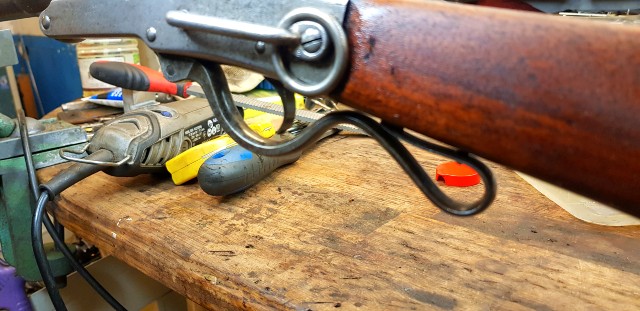

Actual lever is a bit peculiar though. To small to work the thing in any other manner than pulling it between your thumb and index... Works however. No argument there.

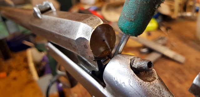

I turned an "expander" on the lathe and as i set to use that the shell separated.  {:( Turns out the old stock shells are out of two parts. The actual case and then that MASSIVE rear rim, and these are simply soldered together.
Well well.. fired the torch up, cleaned the two pieces out and went at it.
As you can judge by the pics in general the various screw heads and what not still looks rather intact. Telling that "Mr Handyman" has never been around this gun, which is ALWAYS a good thing.
That said none of the fasteners were on there all that tight. Cool enough too... Took the thing completely apart, examining the various parts, handing it grease n oil where needed and so on right.. we were in essence good to go.
Uhu. THE shell, only got one thus far. Checked.. and a stock thin wall Maynard shell will take an easy 55 grains of 3F. I have no doubts it´ll handle 60 grains being filled via a drop tube and handed a tad of compression.

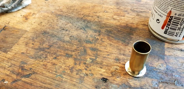

The 50 Beowulf casings showed up. Cut their rims off on the lathe and checked fit in general. This´ll work just fine.. I´m going to braze the stock primer pocket shut tho and redrill with a 0.8mm drillbit, that´ll suffice just fine and make sure that any and all excessive backpressure is kept at bay.
That done, anneal and widen the mouths of them ever so slightly, to accept the 390 grain Smith type boolits i´m to use. In fact, entire case needs to be annealed to be able to fire form vs the chamber.
All good.

Yeah look, so this is going to work just great. What i did was braze the primer pocket and then anneal the entire thing....
That´s quite a step tho. Opening is like 12,1mm and i moved that to 13,25 to take the Smith slugs. Annealing is in other words an absolute must.
Turned a cone shaped tool to bevel the mouths to need be. Now.. that might make ppl ask themselves, how does he get the flared casing off of there?`
No sweat, the tool has a 10mm hole in the center and i turned a 9,5mm punch. Making them come loose is a breeze...
Boolits fit alright, just don´t wanna shove one down there sans powder..  {L*
...n let me tell ya, a 0,8mm drill bit isn´t the largest in the heap...  )L$ )L$
Net result though is thin wall casings of ample capacity that can be rused ´til hell freezes over so.. will chalk this one up as a win.

These days most caliber dimensions are to be found online and as i realized the cost for the "ready made" Maynard brass... HELL NO!
So after spending a little time with google.. yeah well.  =K*
That said, first outing...which of course meant fireforming. In short, this worked a million bux. That simple. Just look at the fired brass. It´s to the point where gas leakage is about nil.
In short, this works as planned and intended and seeing that i can´t but recommend anyone out there to take this route if you ain´t all thumbs.
