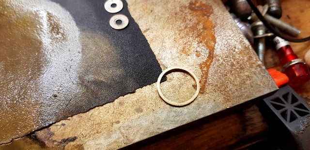

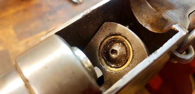

Only part of the gun that shows any appreciable wear is the seal, or rather the sealing surfaces. What i did was turn a brass shim of sorts and installed press fit vs the cutout in the "lid" for the chamber.
Sure handed a way more level surface for the barrel cone to work against.
Uhu. Cleaned that area up rather extensive too. As it turns out this seems to be the hot ticket and if all goes well that brass disc/shim and that cone there will marry best as they see fit under load (read - firing).
We´ll see how it goes.

This Starr, peculiar thing about it is that the only part of it that shows any appreciable wear is the actual breech and its sealing lid. Thus the surfaces needed to be trued, which is one thing, but the fact of the matter is that the sealing surface of the "lid" was beyond reasonable - looking like a damn moon landscape just about.

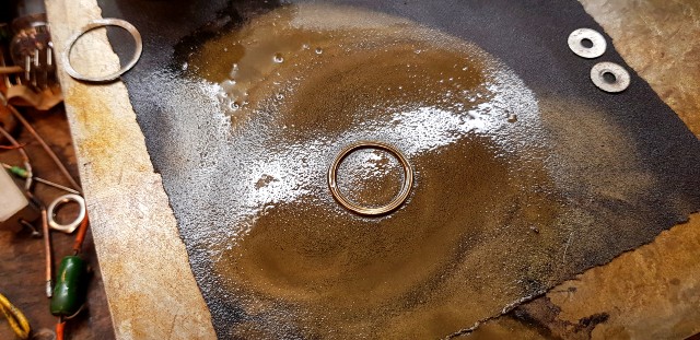

I normally use some sort of yellow metal for this. Reason for this is that it´s, from a tech standpoint, soft and thus repeatably mallable. What´s more it WILL "work harden" and thus come to seal worse n worse by the minute, the more use it sees but.. beauty of it is that all you do to return to zero is that you heat the part up with a torch. Presto, soft again at the drop of a hat.
Well. This time out i cut a "shim" that carries a 20mm outer diameter and a 17mm inner. Practical tests in turn told that the shim needs to be of approx 1mm thickness.
So i cut the shim to 1,1mm and then honed the thing to correct thickness. THIS is the imperative part as i check often as i progress.
N here we go. Ready to be installed.
Indeed. Checking for correct thickness is something do say.. 50 times as work progress. Finally you reach a point where the loading lever lets you know that for the last say 1/2" of movement more force is needed to make the thing close.
At that point..hammer rearwards and finger atop the nipple hole...and blown down the muzzle.
If you´re on the money you´ll just baaaaaarely be able to push any air through.
Then. Just imagine how that sealing surface looked underneath that brass shim- by the picture. Of course there´s no way in hell that by rust disturbed surface will fit 100% vs the shim..
So i install with a rather special 2 comp epoxy. One made for the task so to say. Glue the original surface and the shim both, place the shim in the recess and then close the action. Stiff
Let sit for a couple of hrs so the epoxy gets a reasonable chance to cure.
Of course the spare glue is removed and when done you repeat the "blow test". Most likely it´ll be like..shut.
Since today this Starr is. Shut that is. Of course this is NOT the same as the expanding gasses from shooting the thing but at least we´re at a reasonable level of bypass, one we can live with.
What´s more that shim can be annealed at will and what´s more..replaced at will too. Now i KNOW what dimensions are needed rendering that i can by any means cut as many shims i see fit.
