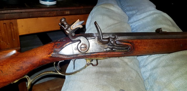

The muskets though,where we´re at,sure needs some attention. Then again,they WERE dirt cheap - being old original flintlocks. Both of them ran 540 Euros inc shipping.
But yeah. Stocks cracked,locks that´s seen better days and so on and so on. Both carry British proof marks though. One been made for the East India company and the other one a "Tower" musket.
Both of them approx 75 cal. Made for patched roundball.

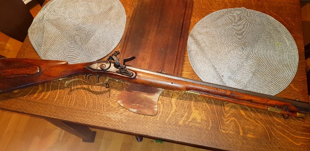

Second one isn´t all that much better off.
Then again...i got what i aksed for. That simple really and i have no issues with that what so ever.
Expect to spend a little time on the lathe and mill both.
First up is to "restore" the two guns. Ie;make them into working guns again. The liner setup is for later...

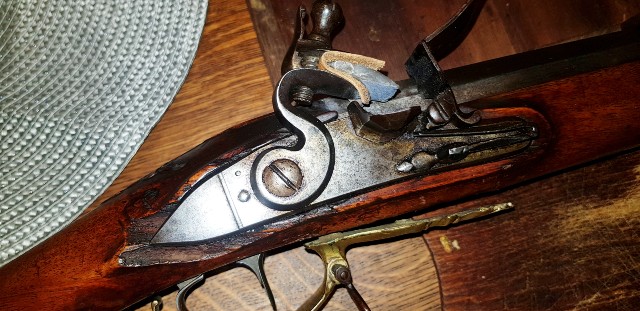

These are OLD guns.
As in over 200yrs old. To most i guess they would be wall hangers,not to me though  {L*
Took the one lock apart today. Time to order som fresh springs,that or have them retempered. In turn not ONE screw or thread was usable anymore  (?^
Well. No fret. Imperative part here is that it´s all there. Which..it isn´t. Missing a bridle,which isn´t the end of the world..i´ll fab one no issues.
Lock on the other one´s intact though,incl said bridle.
That first lock needs some attention though to be honest but then again locks of this style is rather simple to the build so..not the end of the world.
Ambition is quite clear. I want locks that´ll cope handing me the platform to perform 300 meter surgical accuracy. That..takes a bit. M__

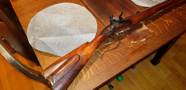

Now. I don´t know why that is but for some reason there seems to be a hell of a difference in wear between a 150+yr old gun and an approx 200yr old gun.
Yup. Worn alright,but this..kind of ludicrous.
Thus far only the one i´ve taken apart but HELLO!  {:(
"Stock a tad broken". Yeah. N then some.. M__
No. It´s not only broken it´s rotten too. Or..rottED. No matter though to be honest. All within the plan and these days the glues available makes short work of that crap.
The major longitudal cracks tho...as some Mr Handyman had been at it before me i started heating them with a heat gun,then scraped the old residue off of there.
Filled the cracks in with a sorts of wood JB...seems to have done the trick. No..cleaning wasn´t it this time out,had to sand the piece..way beyond any and all "clean".
The brass fitting and stock screws..HELL no if to use this piece so.. I had a thorough look for M6*50 screws but none around with the size head needed.
So.
Picked up some M10*70 and let the lathe do what it´s good at.
That said though just LOOK at that walnut. Might very well be that it´s from 1700 something,it´s none the less been abused beyond recognition.
Well well. I´ll turn this around. Too. No worries,will just take a tad of time.
That "sorta JB" i´ve just added. Will let that take a set then cut a "ditch" which i´ll fill with Titebond and walnut dust. But OH is there EVAR a few of them cracks..  {:(
