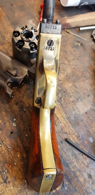

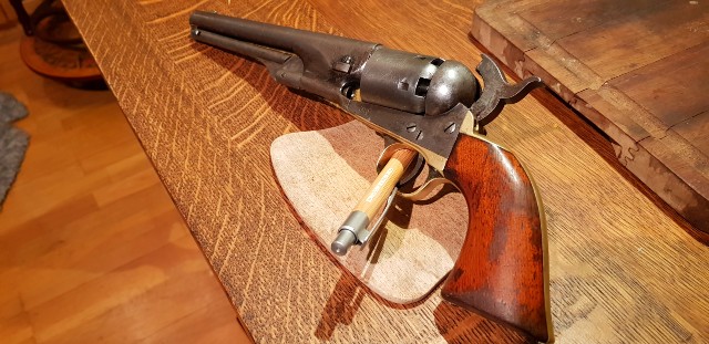

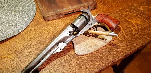

Yeah. LOADS of Navy Colts lately! The -61 IMO a more pleasing to the eye gun than the -51. But hey, that´s just me! Might be that the -51´s are like a dime a dozen..might very well be.
None the less.
Again, a few broken internals and a tad "loose". Never a good thing with a Colt style revolver.
Yeah. That and again...cones. Frozen solid. Ain´t they always!
Indeed. From a looks point of view very much like the 1860 Army, but then again not. Like an army that shrunk when thrown into the washer.. Makes for a very neat handling gun though, and as stated one looking real good doing it too.
Could you toss cylinders between the -51 and -61? Yeah, i guess. If that was your intent.

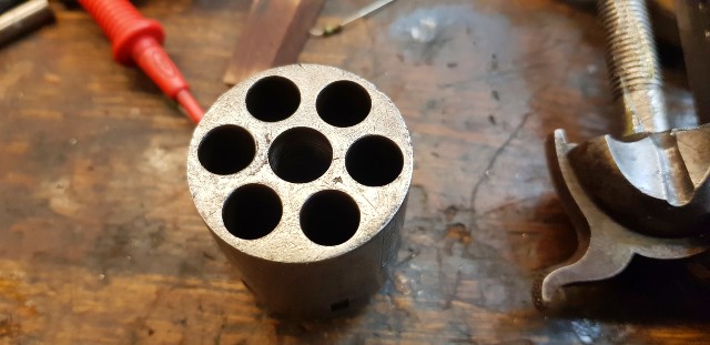

The old original Colts often show wear to the cylinder, this one being no exception. Something handled by adressing the arbor hole in it. Anyways.
Seeing that it´s also rather common that this wear is at the cyl front face. This one though cleaned up nicely by just a slight polish on my steel flat.
End shake well within par
Now. As much as i´ve got a couple of -51´s laying around in the cabinets around here i sure wouldn´t mind a -61 too. So..time to have half an eye open i guess.
