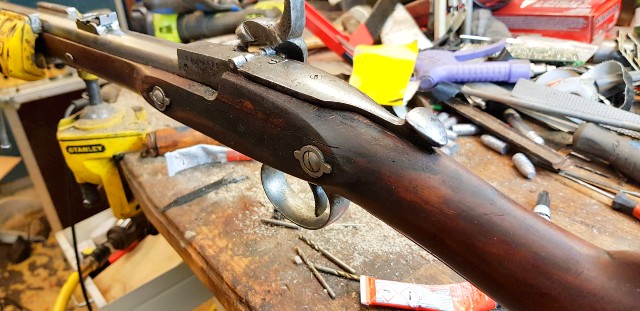

Weeeeeeell...this sure could have ended up way worse.
Now listen up boys and listen sharp. We went shooting right, them two Tails along. The longer of the two, i had had issue with the lock of it being overly stiff but didn´t really think twice about it.
Being familiar as i am with the setup.
Well.
My turn. Loaded the longer Tail up with a cartridge and slammed the lid shut, i thought. Note..be aware that the last thing entering the chamber is a greased wad to sit between the plunger of the locking system and the rear of the cartridge.
Ie; when charge goes boom that greased wad smears out all over the plunger, which is now locked in place, and thus creates a gas tight seal.
It SHOULD work like that. The lock on THAT particular gun, stiff. Didn´t think twice about it and fired the thing.
Due the lock not being completely in battery part of the blast came out rearwards. Towards me. Friend Patric who was like 4 feet off said "Man! Your entire head was a ball of fire!"
The blast cracked a small piece of the stock adjacent to the lock and sent that flying.. we never recovered that. Me though, all said and done i was absolutely alright. Realizing that this might VERY well have gone a different path.
Lesson learned though and since that lock has certainly been repaired. As.. as it turns out the former repairs to the stock in that area had been done with contact cement... so help me god.
I TRULY wanna kill Mr Handyman!!!  ^y% ^y%
Of course i took all of it off, scaling half the stock off out rear, and redid the entire thing with 2 comp epoxy. These parts aren´t really that highly loaded why it will most likely suffice just fine as a repair.
As is the thing is curing but.. i suspect it´ll take a few apps of dye to reach the more or less correct hue. All good though.
That said guys..whoooooha... Take my word for this!  {_K
After the incident though i did the only reasonable thing and went right up there and kept firing away. So from that aspect we´re good..
Close call though. To close for comfort.

Glad you are unscathed. That coulda been uuuuuuuuugly.
Re: Westley Richards "monkey tail" short rifle
« Reply #78 on: October 25, 2020, 08:21:59 PM »
Yes.
Yes it could. All to aware, why i post about it. Guess my name wasn´t up. Simple as that.

Even with glasses I would have made a mess in my underwear, I only have one eye and am a bit attached to it, glad you are ok
« Reply #80 on: October 25, 2020, 08:44:41 PM »
Indeed happy i wore eye protection.
Thx Grumpy.

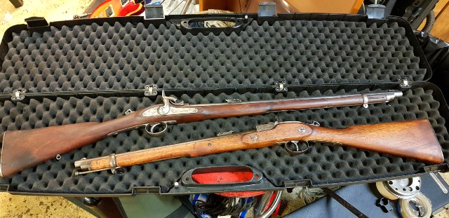

Ah!
The carbine.
Huh. As the 25" barrel one sure threw a fit on me i pushed forward with the formerly very ill repaired carbine, and finally touched ground.
Last thing up was a tad of dye. "Dark oak" and "Mahogany" mixed made for a world of difference. Now layer upon layer of oil...
So. Time for a rematch and pulling a load ladder to see what she tells. Truth be told though, seeing the capacity/capability of these guns i´d SURE love a diopter setup of some sorts.
Seeing what this is though i´ll in such a case shoot for an old one. A new Pedersoli or the likes is OUT. But..a diopter setup on a 90cm long gun..  )L$ )L$
..then pulling a few shots with it and prove that it actually makes good USE of it.. )L$ (?^ (?^
