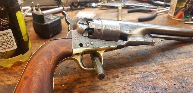

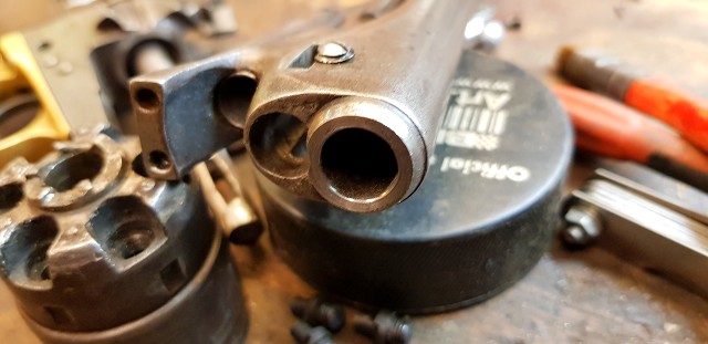

Been with me a couple of times, and a while back i was asked to replace the axis pin - which i did. Worn, of course, but with the new one in place radial play was about nil so..
Ditto. End shake on the large side of things, so i welded the entry up and reshaped on the lathe. All good i guess.
So?
What´s the issue then?

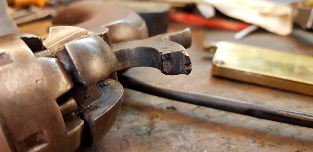

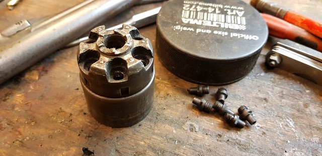

Well. In a nutshell, this little bugger. It elapsed me completely to shove the bore scope down the barrel but as i finally did i understood perfectly well why it wouldn´t shoot worth a crap and to part actually come apart!
As it turns out the 6 holes are anything but even. Some placed to high and what not. Have since thus handed the piece a rather liberal forcing cone job, and will now try it out as such, but in all honesty..

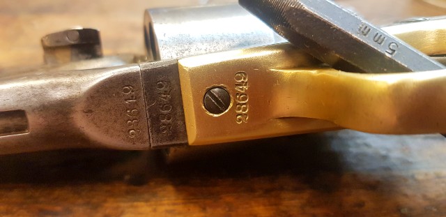

What gets me is that the gun is all numbers correct yadda yadda and what not right. So HOW has this TURD come to pass through the gates at the Colt factory?
Cause at a minimum it must have spat lead all over the place, yes even with end shake in order.
Anyways...

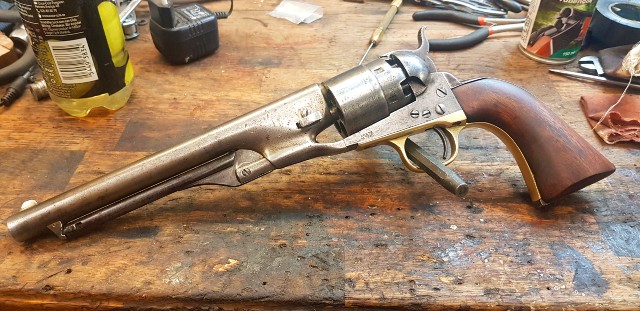

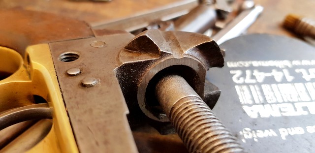

It´s all reset now and all in good working order. Sry to say the threads for the axis pin in the frame was molested to the point where Heli-Coil was the only solution.
That said though, that job came out 100% so from a pure practical POW we´re all good to go.

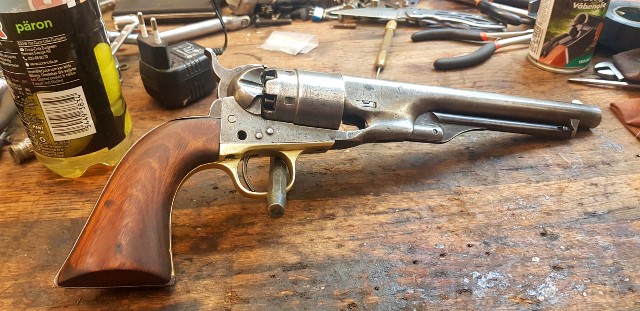

Mark. In contrast to our beloved Remmys the original old Colts are very very often in a rather poor state from a mech point of view. Rattle cases if ever.
After having tossed the entire BOOK at this thing it is anything BUT anymore and i honestly expect it to deliver accordingly.
Yep. Tighter than a hammered to death door nail now... Nipples are of course new too.

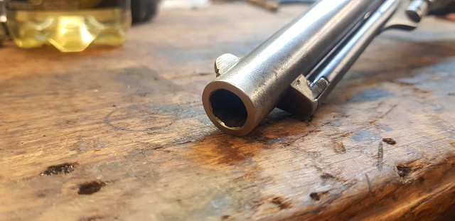

Rifling i´d say isn´t only fair it´s even better than ok. However it showed a tad of pitting at the utmost end of the barrel innards and in turn rather heavy muzzle wear on the outside.
Not so anymore.
Yeah. On a general whole i´d say we´re in business. Hand as well as bolt and springs and what not - new. Timing is absolutely 100..like clockwork and it locks up like a damn vault.

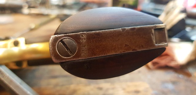

Only thing missing, as this is an early gun, is the "plug screw" for attaching the shoulder stock. These earlier guns often had that option.
Uhu. Indeed. What´s there to add really?
Yep, that too. Mark the notch for the shoulder stock.
