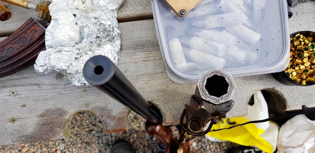

So. We went shooting.
Nope. Still not even close. Of course this could always be reasoned as driver induced but once and for all.. When we sit down at 100 meters with the Anschutz both me and Patric will deliver groups that to the LETTER can be covered with a regular man sized thumb nail.
What i´m saying by that is.. we´re no newcomers to this.
Sry to say this is rifle induced and i´m currently doing my damndest trying to figure out what´s going on here.
Thing is.. The difference in min diameter comes down to like 6/100mm and that might very well be the idea of a choked barrel. But in that case, what WERE they thinking as far as loads at St Etienne at the time cause this is getting nowhere... fast.
ALL the needed attributes are there! This is no doubt a fast twist 45 cal rifle made back in the day as a high accuracy smoke pole! No two ways about that...
That shorter bullet i designed, idea was for a "short range" pill. But.. we´re still all over the map. As we get even a HINT of "we got it!"... nope.
What we´re going to try now is to physically drill a "minie hollow" out rear and see if that aids any. Thinking being that.. might be we´re asking the bullet to expand from a solid base way to much?
Please keep in mind this rifles downright INSANE rifling depth. Idea we´ve got is not to make the bullet seal but just to get it to take to the rifling earlier than it SEEMS to do deep within the barrel upon firing.
We really should fire into water to get an idea of how the bullet looks as it exits the muzzle. Where to pull that off tho?
Here they are. Sized to 11,09mm and that brings that as we shove them down the pipe.. we simply can´t ASK for a better fit. It´s that simple.
Bullet stays that tight for like.. 600mm out of the barrels 800mm total. As it closes in on the breech it´s like it rattles in place.
If this goes to hell in a handbasket i´ll friggin turn the tools needed out of SIS-2241 steel to scuff that insane rifling down, 1/10 of a millimeter at a time (which equals 5/100mm per land) and keep doing so until i see a uniform dimension at around 11,45mm. Or.. 450 caliber if you so wish.
The grooves are all in at approx ,460" so.. spare to go need be.
