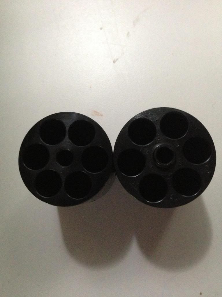

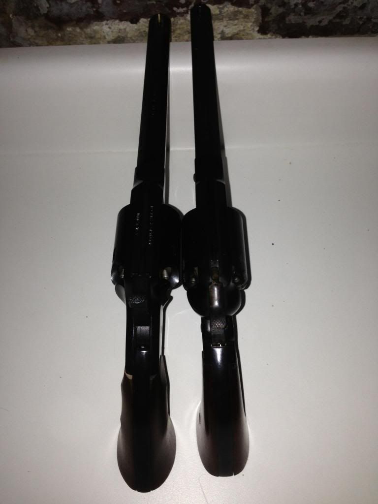

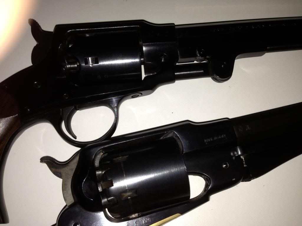

Just purchased a 2000 Euroarms Rogers & Spencer with extra cylinder. In excellent shape with what appear to be stainless steel nipples on both cylinders.
Just thought I would offer some initial observations and comparisons with my 1970 Uberti 8" 1858. Pics to follow:
Rogers & Spencer:
Barrel: 7.5" octagaon
2.5" around
5/16" (.312") per flat
1 5/8" cyl diameter
Cyl wall narrowest: .078"
Cyl Mouth: .450" (avg)
Wrist: 1 1/4"
Frame height in front of Cyl: 2 3/16"
Top strap width at Hammer slot  3/4"
Hammer width just in front of firing "spur" ext: 3/8" (.375")
Muzzle width across octagon flat: 46/64" (.718")
Backstrap: 3/8"
WEIGHT: 1290 grams (2.84 lbs)
1858 Remington:
Barrel 8" octagon
2.25" around
9/32" (.281") per flat
Cyl wall narrowest : .062"
Wrist : 1 1/8"
Frame height in front of cyl: 2 1/16"
Top strap at hammer slot 3/4"
Hammer Width at spur/ext: 5/16" (.312")
Across muzzle flat 42/64" (.656")
Backstrap: 3/8"
WEIGHT: 1175 grams (2.59 lbs)

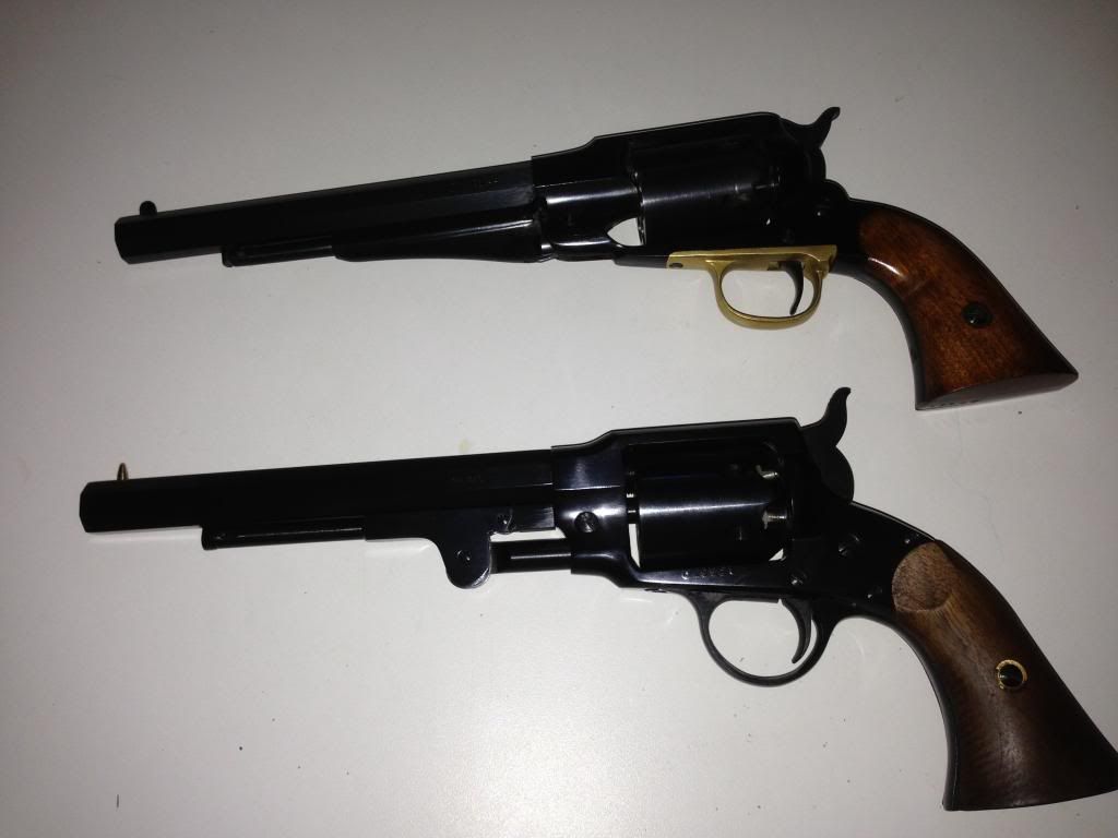

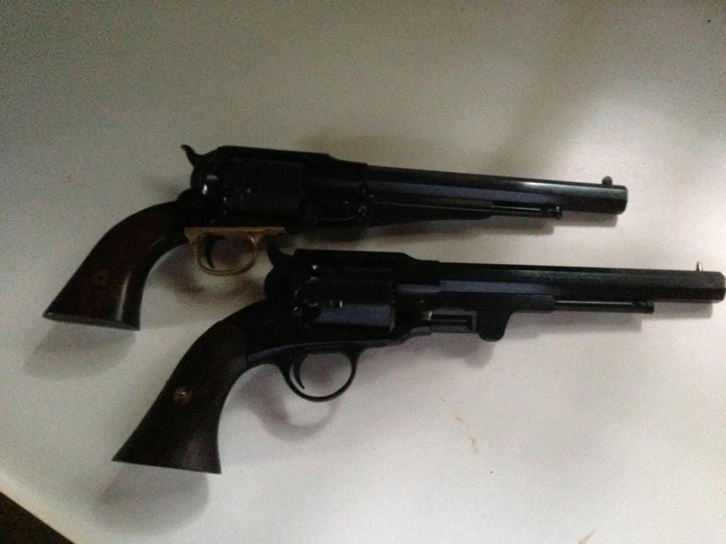

While only 1/4 of a lb heavier than the 1858, the R&S feels much larger and more solid, largely due to its bigger grips in my opinion. It has the feel and heft of a Ruger Blackhawk. It is much more balanced than the barrel heavy 1858 but still points well. It feels much more like a modern revolver. The 1858 however feels and looks more elegant. R&S grip is longer and larger, more suited to 2013 sized hands than the 1858 but not having shot it yet, I can't say what this means from a felt recoil and sight management perspective.
While almost everything on the R&S is slightly beefier than the 1858 in a couple of key strength areas, they are the same size, notably backstrap width and frame width.
My initial summary is that the 1858 is a more elegant firearm while the Rogers and Spencer the more brutal and more likely to handle very heavy duty charges - charges really not necessary however to produce desired results. The next thing will be to see how the R&S shoots!

Yes, by .047". Sorry I forgot the 1858 Cyl measurement above - will  edit. This is because the R&S has cylinder walls that are .016" thicker both between chamber mouths and between chamber mouth and outside of cylinder, necessitating a larger diameter cylinder.
R&S
1 5/8" cyl diameter (1.625"
1858
1 37/64" (1.578")
Almost everything on the R&S is just that much beefier, though not backstrap and frame width. Not sure whether this was the case on originals, but it could also be to simplify manufacturing since Euroarms made 1858 Remingtons and R&S revolvers concurrently.  It seems very much that Rogers and Spencer took an 1858 and said, what can we do to copy it and make it better without egregious patent violations?. Capping is made much easier with the large opening around the nipples, for example. But they swung and missed with the loading cutout. I cannot fit Lee 200 gr conicals into the cutout for loading on the gun. And while grip size is much larger and (for me) better, the super high hammer thumb spur would be tricky for finger and thumb length challenged individuals.
It does however feel very solid. As I said, it reminds me more of a Ruger Blackhawk. And it points better than the barrel heavy 1858.  It has however a kind of sinister brutality about it whereas the 1858 Remington is an elegant weapon in design and handling. In fact, the two pistols seem to reflect changes in society for their times. The 1858 was designed in a happier age and age, one before families were torn apart and hundreds of thousands of Americans killed each other in battle, one in which aesthetics were an important factor in design. The Rogers & Spencer reflects the brutal industrial efficiency of the Union being brought to bear to bring a close to that War, one in which function only guided design.
It is however my contention based on this initial evaluation that had the R&S been released early enough to have been distributed to the Army and seen action in the Civil War, it would have made a large subsequent mark on the civilian market. Remember, troops were allowed to purchase their sidearms on release from service. It is a more "modern" and solid gun than either the Colts or the Remingtons. Colt's use of their brilliant 45 cal cartridge may well have still produced the same results, but an R&S buyout by Remington or S&W would have given them the basis for more credible competition.
Oh, one more R&S design flaw. The only significant one in my mind and quite substantial. While some of us my bemoan the inadequate depth of the safety notches on our 1858, that is easily rectified with a little file time. On the R&S, there are no safety notches between the caps nor is there room to file one or more. I find that a piece of leather/rawhide cord placed in the hammer slot will ensure no hammer - cap contact, but the safety notches on the Remington are far superior.

 I have both the Euroarms R&S adjustable sight version and the Euroarms fixed sight version . I can pick up either of these and hold it out in front of me and the sights will be inline right away. A very well designed shooter.
 The grip is the type that you will like or dislike on first impression.If you don't like it ,after shooting it you may change your mind or not but you will have done some of your best shooting non the less.
