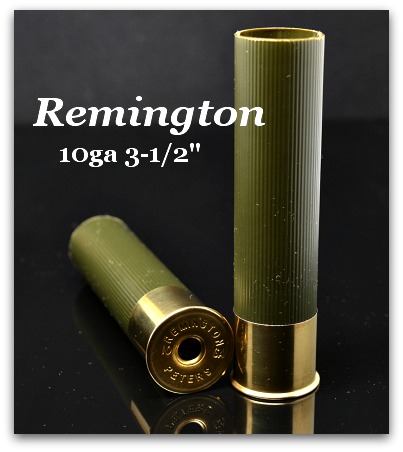

Well, I might have a problem.
So, let's kick it around.
Nominally, the shotgun is a 10g.
I finally found some 10g shells.  Remington RP, the green plastic ones, high brass.
Purchased the low-base wads, 10g.
First, I dropped a plastic shotcup/wad down each barrel, base-first.  The base didn't touch the walls until almost to the muzzle.
Second, I trimmed a shell to 3", expected it to be a quarter inch too long.  The forcing cone starts at 2.70" from rear of chamber, tapers to barrel dimension at 2.75" - but the shell slid all 3" into the barrel and extracts like butter.  I can tip the barrel up and let the hull slide out.
This means both shells inserted past the forcing cone, which means the barrels (just past the forcing cones) is the dimension of the outside of the 10g shells.
Third, I sent an untrimmed 3.25" shell into the chamber, and it went in almost all the way before it touched the barrel sidewalls.
I think, that I have a 9 gauge?  Chamber measures .853 where the brass base inserts.
Q1.  Is it safe to "fire-form" the RP shells to these chambers?
Q2.  Should I trim the cases back from 3.00" to 2.700"
Classanr

« Reply #20 on: October 26, 2013, 06:58:29 AM »
There is no nine gauge. The rear of the 10 gauge chamber should measure .859. Fired shell length should be 2 7/8 and be roll crimped when loaded

Thank you for the reply.  I might not have been fully clear on my intent and concern.
Yes, no "nine gauge".  I was being silly.  And yes 2 7/8 "should" be the chamber length.  But quoting from a knowledgeable previous post:
I wouldn't shoot smokeless out of it and chamber length is probably short.
I measured the chamber.  Instead of 2.875, the chamber is 2.700 to start of forcing cone, 2.75 at end of forcing cone, thus "probably short".
Shooting BP, (or to be more specific, BlackMZ) I wish the shell to be "brass length" and to load as one would do with brass hulls, specifically to water-glass an over-card to the top of the hull to keep the powder, wad, and shot column in.
Should I trim the total hull down to pre-forcing-cone chamber length if I'm not roll-crimping (as one would with brass)?
Am I safe to ignore the hull-to-chamberwall gap with unfired plastic hulls?

« Reply #22 on: October 26, 2013, 08:26:12 AM »
The chamber should be 2.65 to start of forcing cone. You can cut the shells to 2.65 and glue the over shot card in. The chamber should taper down to .845 so your plastic hulls should work fine.
Maybe this will help. http://www.dave-cushman.net/shot/shotshellloads.html
