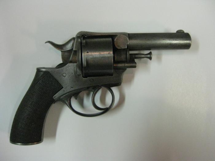

Let us consider the case length:
.45 Colt Case length   1.285 in (32.6 mm)
.45 ACP  Case length   .898 in (22.8 mm)
and their cousins:
.450 Adams (1868) Case length   .69 in (18 mm)
.455 Webly Mk1 (1891) Case length   0.886 (22.5mm)
firstly, for smokeless shooting with lead bullets, it gives me smaller case (like the .45 cowboy)
which is more efficient for smokeless, and safer from a reloading point of view. As our good
Necessary points out, with lead loads it is well within specs, and gives fair dinkum results!
secondly, ( As mike goon pointed out) since the case seals the cylinder from the back side, this gains me 0.387 inches
of additional useful bore-size chamber before we hit the barrel-cylinder gap, which does in fact add time for the expanding
gasses to provide just a tad more velocity.
lastly, since my severely cut-down remmy is a bit of an abomination in the first place, using a cartidge
very much like a rimless .455 Webley, or a Snubnose Webley RIC it takes a bit of the sting out...
Webley RIC 1868 cal .450 CF
George H. Daw British R.I.C. Revolver .450 Adams
or the 1880 ish webley mk1
I have plenty of histerically correct toys, this is just my little steampunky abomination   :-[
